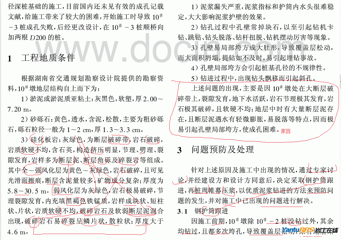

断层破碎带大直径深桩基础的施工 64y9.PY
http://jz.docin.com/p-513423373.html o5+7Lt]
