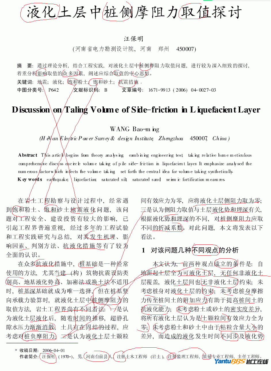

桩土摩阻力研究综述 |^!
http://jz.docin.com/p-311085960.html
62151
434638
5195
只看该作者 4楼 发表于: 2017-09-05
桩侧摩阻力计算 (s?Rbd
http://www.doc88.com/p-7863343186101.html $~s|%>@
液化土层中桩侧摩阻力取值探讨 $-Wn|w+h<a
http://www.doc88.com/p-999287870788.html
