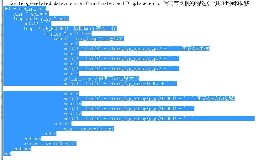

在看郑海棠老师Flac3D2Tecplot_new.dat时看到info_flag时看不懂了,请问info_flag在flac3d 3.0版本fish语言中是什么意思啊?
;; Write gp-related data,such as Coordinates and Displacements,写与节点相关的数据,例如坐标和位移
def write_gp_info
    p_gp = gp_head
    loop while p_gp # null
        buf(1) = ''
        loop i(1,N_RECORD); 数据每5个存放一行
            if p_gp # null then
                caseof info_flag;什么意思?
                    case 0
                        buf(1) = buf(1) + string(gp_xpos(p_gp)) + '  ';某节点x坐标
                    case 1
                        buf(1) = buf(1) + string(gp_ypos(p_gp)) + '  '
                    case 2
                        buf(1) = buf(1) + string(gp_zpos(p_gp)) + '  '
                    case 4
                    get_gp_disp;计算某节点位移大小
                        buf(1) = buf(1) + string(gp_disp*1000) + '  '
                    case 8
                        buf(1) = buf(1) + string(gp_xdisp(p_gp)*1000) + '  ';某节点x方向位移
                    case 16
                        buf(1) = buf(1) + string(gp_ydisp(p_gp)*1000) + '  '
                    case 32
                        buf(1) = buf(1) + string(gp_zdisp(p_gp)*1000) + '  '
                endcase
                p_gp = gp_next(p_gp)
            endif
        endloop
        status = write(buf,1)
    endloop
end
