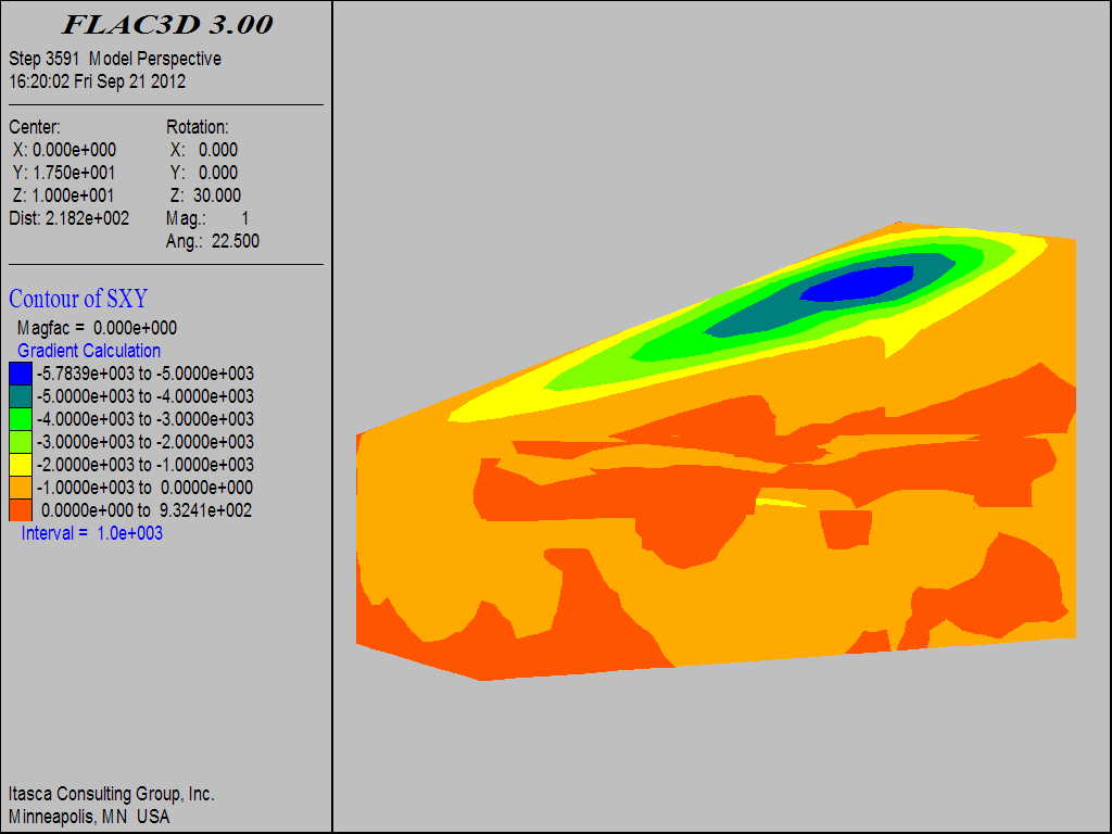

我的数值模型,计算时没问题,可出应力云图的时候,感觉不对.,谁能帮我看看?

什么都没有,别人没办法看。
建议看看边界条件。

下面是我的数值模型:
new
gen zo radc p0 (0,0,0) p1 (36.3,0,0) p2 (0,35,0) p3 (0,0,8)&
d (6.3,5.3,6.3,5.3) size 6 7 6 5 rat 1 1 1 1  group 围岩1
gen zo cs p0 (0,0,0) p1 6.3 0 0  p2 0 35 0 p3 0 0 5.3 &
d 6 5 6 5 size 3 7 6 6 rat 1 1 1 1 gro 初期支护 fill group 原岩
gen zo  reflect nor (-1,0,0) origin (0,0,0)
gen zo b p0 10 0 8 p1 36.3 0 8 p2 10 35 8 p3 10 0 20 p4 36.3 35 8 &
p5 10 35 25 p6 36.3 0 30 p7 36.3 35 35 size 5 7 5 rat 1 1 1 gro 围岩2
gen zo w p0 (10,35,8) p1 (-36.3,35,8) p2 (10,0,8) p3 (10,35,25) p4 (-36.3 0 8) &
p5 10 0 20 size 18 7 6 rat 1 1 1 group 仰坡
gen zo b p0 (36.3,35,0) p1 (36.3,0,0) p2 (-36.3,35,0) p3 (36.3,35,-15) size 7 20 5 rat 1 1 1 &
group 围岩3
attach  face  ran z 7.9 8.1
attach face  ran x -36.3 36.3
attach face  ran z -0.1 0.1
save 模型.sav
model mohr
pro bulk 1e7 shear 3.34e6 coh 20e10 fr 15 ten 0
fix z x y  ran z -15
fix x ran x -36.3
fix x ran x 36.3
fix y ran y 0
fix y ran y 35
ini  dens 1600
set grav 0 0 -10
solve elas
save 初始应力场.sav
ini xdis 0 ydis 0 zdis 0
model null  range  gro 初期支护
model null range gro   原岩
step  100
save 开挖后.sav
model ela  ran gro 初期支护
pro  bulk 2.5e10  shear  1.875e10   ran  gro 初期支护
hist unbal
plo hi 1
solve
save 最终.sav
