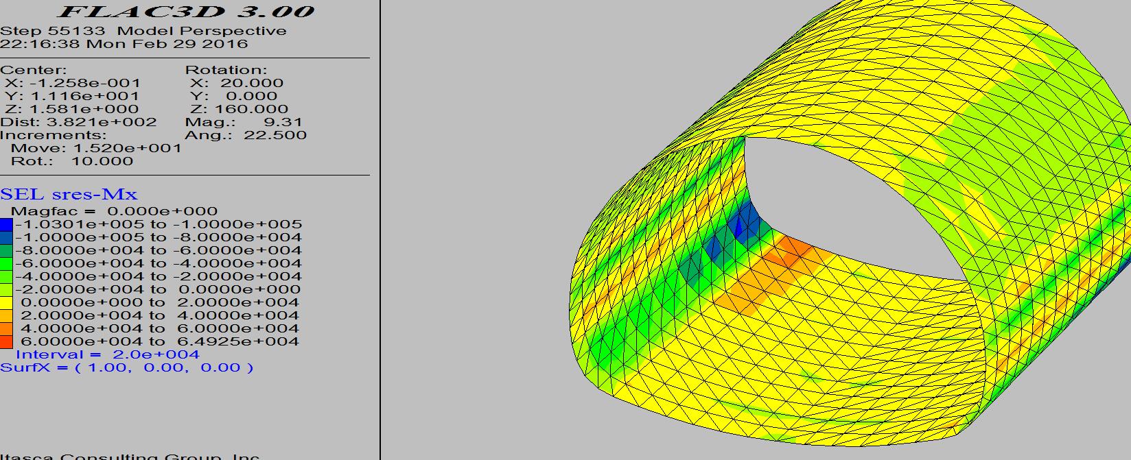

计算出了结果,想提取shell单元某一位置的弯矩和轴力,比如id为1,应如何写命令流》谢谢!!

就如图中的情况

rest 57.sav
def array_initiate
  array line(40000)
  line_ptr=0
end
@array_initiate
def force_outp
  command
    sel recover surface surfx 1 0 0
    sel recover sres
  endcommand
sp=s_head
loop while sp # null
  np=s_node(sp,3)
  nid=nd_id(np)
_xcent=nd_pos(np,1,1)
_ycent=nd_pos(np,1,2)
_zcent=nd_pos(np,1,3)
   if s_type(sp)=6 then
   if _zcent < -44.9 then
   if _zcent > -45.1 then
      mm = sst_sres(sp,3,1)
      xx = _xcent
      yy = _ycent
      zz = _zcent
      nnid=nid
         line_ptr=line_ptr+1
   line(line_ptr)=string(mm)  + ',' +string(xx) + ',' + string(yy) + ',' +string(zz) + ',' +string(nnid)
   endif
   endif
   endif
sp=s_next(sp)
endloop
end
@force_outp
def file_write
  filename=filename
  filename= 'mmmmmmm_nx.txt'
  file_status = open(filename, 1, 1)
  file_status = write(line, line_ptr)
  file_status = close
  ;filename2=filename2
  ;file_status = open(filename2, 1, 1)
  ;file_status = write(line2, line_ptr)
  ;file_status = close
end
file_write
;rest exca-c5
;call pile_data
;set @filename='pile_mz5.txt' @filename2='pile_xdis5.txt'
;@file_write
