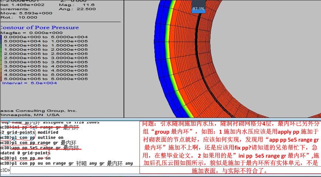

{求教}水工引水隧洞内水压施加于衬砌表面节点的实现 [复制链接]

哪位兄弟知道的望不吝赐教  谢啦!

pp应该施加到某一边界上,而不是某些单元上。

嗯嗯  就是要施加于衬砌(实体模拟)表面的节点上,哥们  应该怎么实现??可否告知

不知道楼主想算渗流还是想算力学,算渗流的话才需要pp施加在节点上,如果你只是算力学考虑到孔隙水压力的影响,建议把pp施加在单元上,用
config fluid
set fluid off
set zonebasedpp on
施加的话直接用Fix pp = blabla

哥们  要算渗流的哦,如果不考虑渗流的话,就不用打开config fluid 渗流模型了,直接app nstress施加面力就行,算渗流的应该怎么整哦  ??

你的模型是不是标准圆环形状啊?如果是标准圆环形状试试:
fix pp = blabla range end1 x1 y1 z1 end2 x2 y2 z2 radius r1 r2

哥们    你觉得考虑了衬砌渗透系数,考虑渗流的话是用命令FIX PP吗???那我试下

。。。您这个blabla是指孔压值??

不然嘞:P (剩下的是凑10个字数的)

引用一下手册上的原话,我懒得翻了:)
Pore-pressure fixed – This is a permeable boundary across which fluid flows
to and from the outside world. !!!The saturation may only vary if the set pressure
is exactly zero. Otherwise, saturation is forced to be 1 (to conform with
FLAC3D’s assumption that pore pressures can only exist in a fully saturated
material). Pore pressure cannot be fixed at a value less than the tensile limit;
FLAC3D will reset any such pressures to the tensile limit.
