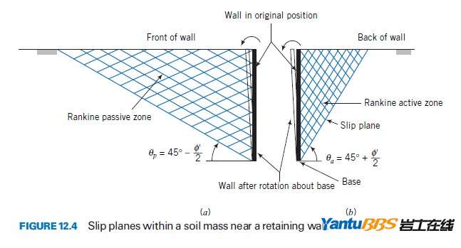

Attached is illustration for Rankine failure zone theory.
In this problem, the issue is to talk about passive failure.
Good Luck to Me!

回 jijian 的帖子
jijian:Attached is illustration for Rankine failure zone theory.
[图片]
 (2013-09-12 10:17)
虽然哥们全飚英文,但是看明白了,申请置顶!
