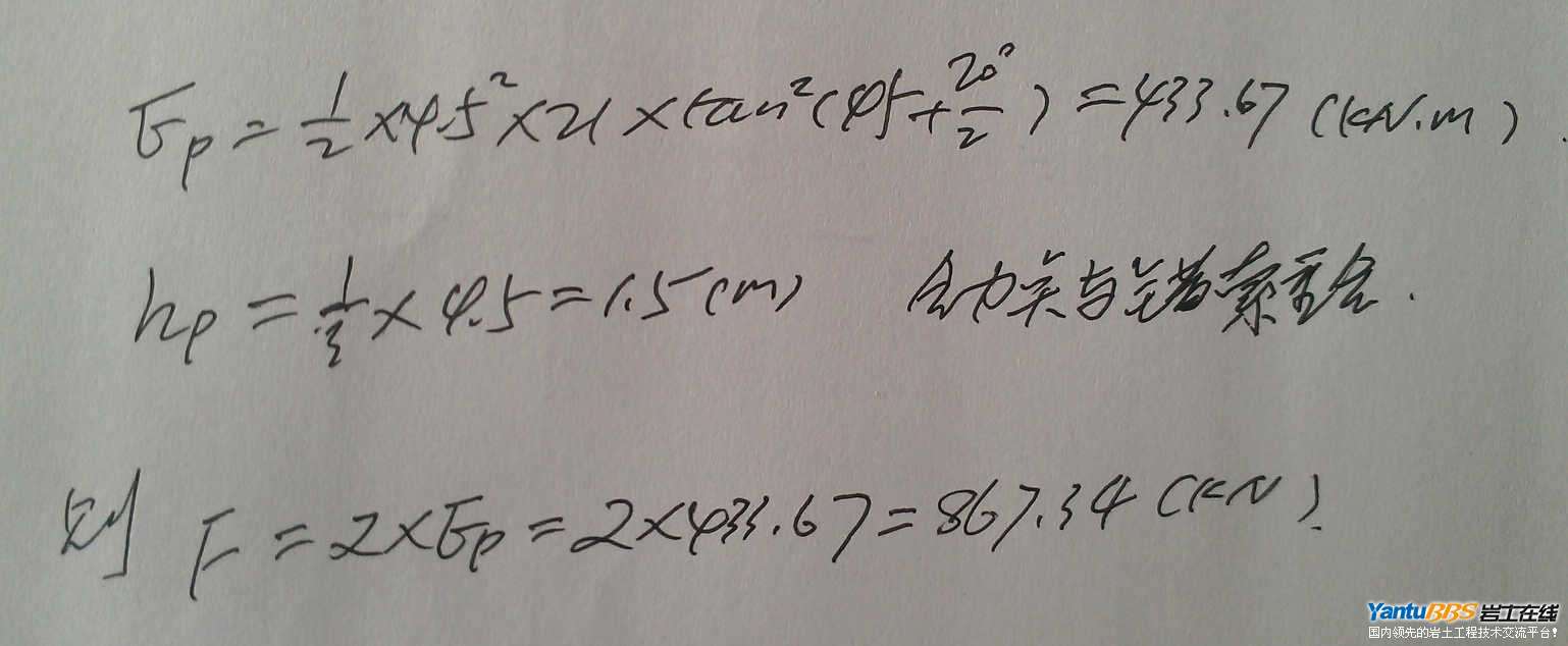

好像是D 吧。

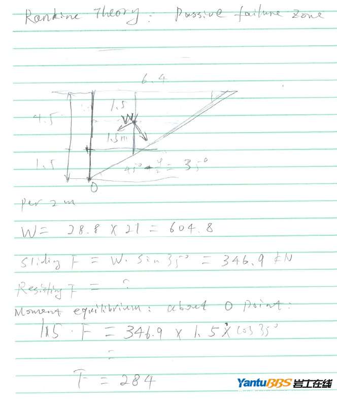

As per my calculation, the correct answer is 283. So B should be the right.

Con-sider the overall passive failure, draw a line sloping at 45-20/2=35, then get the passive failure zone.
Solve the moment equilibrium, then you can find a solution of 283.

回 zyhvvbb77 的帖子
zyhvvbb77:好像是D 吧。[图片] (2013-09-12 08:43)
According to your solution, the level arm of reinforcement is useless. Is it reasonable?
Good Luck to Me!
