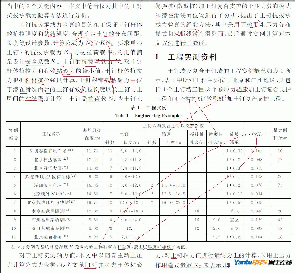

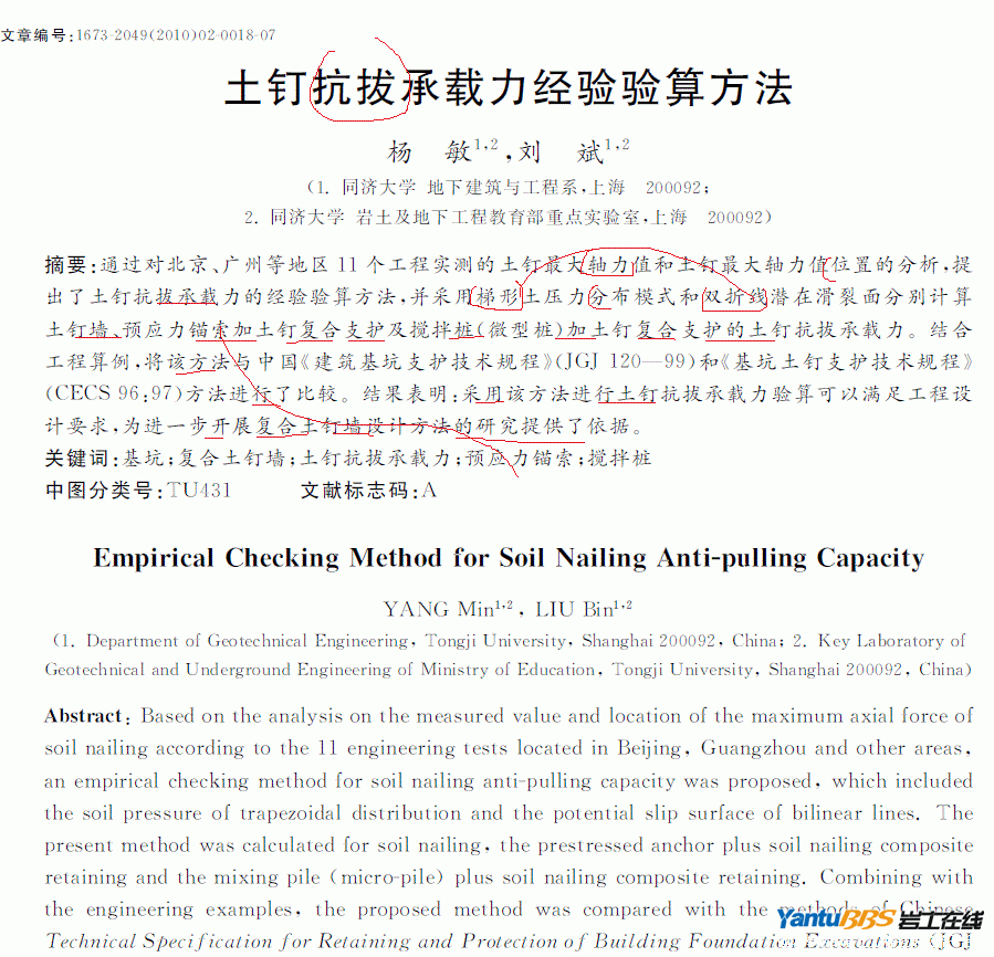

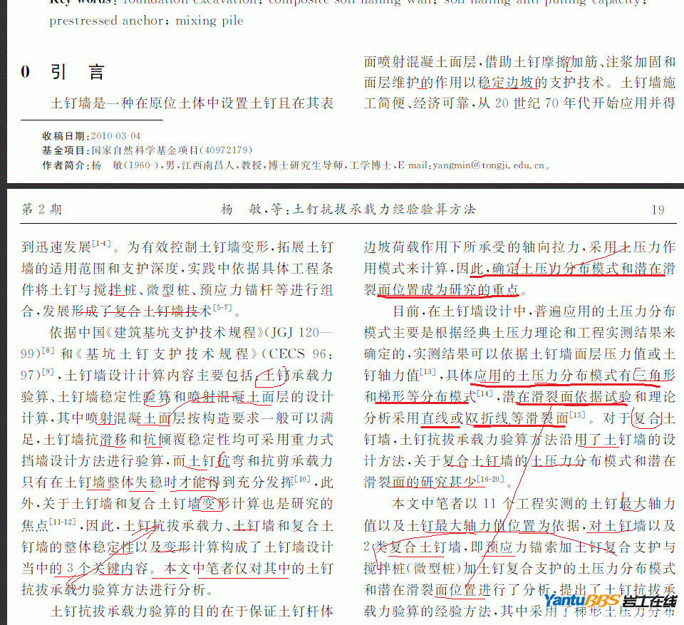

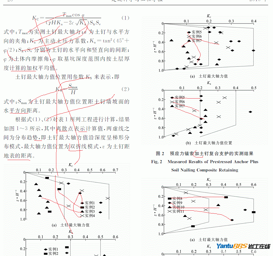

土钉抗拔承载力经验验算方法.pdf 3MHpP5C
ht ps://max.book118.com/html/2017/0523/108509290.shtm TsoxS/MI"
