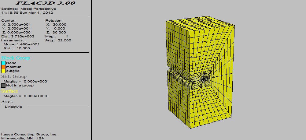

求助  彭文斌书上 隧道支护无颜色显示 [复制链接]
离线xiaogancw
946
只看楼主 倒序阅读 使用道具 楼主  发表于: 2012-03-09
new
;主隧道
gen zone radcy p0=(15,0,0) p1=(23,0,0) &
               p2=(15,50,0) p3=(15,0,8) &
               size 4 10 6 4 dimension 4 4 4 4 &
               ratio 1 1 1 1 fill group MainTun
gen zone reflect dip 90 dd 90 origin=(15,0,0)
gen zone reflect dip 0 origin=(0,0,0)
;辅助隧道
gen point id 1 (3,0.0,-1)
gen point id 2 (3,50.0,-1)
gen zone radc p0=(0,0,-1) p1=(7,0,0) &
              p2=(0,50,-1) p3=(0,0,8) p4=(7,50,0) p5=(0,50,8) &
              p6=(7,0,8) p7=(7,50,8) p8=point 1 p10=point 2 &
              size 3 10 6 4 dimension 3 3 3 3 ratio 1 1 1 1
gen zone radc p0=(0,0,-1) p1=(0,0,-8) &
              p2=(0,50,-1) p3=(7,0,0) p4=(0,50,-8) p5=(7,50,0) &
              p6=(7,0,-8) p7=(7,50,-8) p9=point 1 p11=point 2 &
;辅助隧道支护
sel shell range cylinder end1=(0,0,-1) end2=(0,50,-1) radius 3
;主、辅隧道外围网格
gen zone radtunnel size 9 10 3 10 &
    p0=(0,0,0) p1=(50,0,0) p2=(0,50,0) p3=(0,0,50) &
    dimension 23 8 23 ratio 1 1 1 1.1 &
    group outgrid
gen zone reflect normal=(0,0,-1) origin=(0,0,0) &
    range group outgrid
group servic range cylinder end1 0,0,-1 end2 0,50,-1 radius=3
plot add block group cyan orange yellow
plot add sel group shrinkfac 2.0 dgray
plot set rot 20 0 30
plot set center auto
plot add axes
plot show

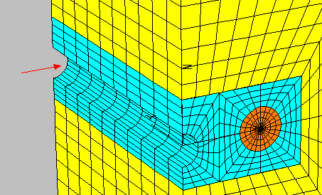

彭文斌书上的为黑白图,但是支护部分有明显的颜色深浅差异

你想问什么呢?有颜色才是对的吗,书是黑白的,肯定不显示颜色啊,我觉得可能是书上有问题,颜色变化怎么也应该用深浅来表示啊。。。
离线xiaogancw
946
只看该作者 4楼 发表于: 2012-03-11
书上是黑白显示的,你将彩色的调成黑白看看,还是跟书上不一样

我就是按照书上的程序编写的,怎么得到的图是这样的呢?
