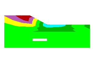

flac 5.0 做应力图 外轮廓会变形吗  急 [复制链接]

只看该作者 1楼 发表于: 2013-06-04
这是怎么回事  用FIX约束了

只看该作者 2楼 发表于: 2013-06-04
把命令流传上来,土友好帮你看哪!

只看该作者 3楼 发表于: 2013-06-05
回 edelmann 的帖子
config
grid 70,40
model elastic
model null i 31 70 j 37 40
group 'null' i 31 70 j 37 40
group delete 'null'
gen 0.0,36.0 0.0,40.0 25.0,40.0 30.0,36.0 i 1 31 j 37 41
mark j 9
mark j 11
mark j 19
mark j 29
mark i 1 31 j 37
group 'c30' region 18 38
model mohr group 'c30'
prop density=23000.0 bulk=1.66666998E10 shear=1.24999997E10 cohesion=3180000.0 friction=55.0 group 'c30'
group 'c30' region 25 32
group 'c30' region 40 26
prop density=2500.0 bulk=1.84342999E10 shear=1.55983002E10 cohesion=3500000.0 friction=60.0 group 'c30'
group 'yan' region 35 15
model mohr group 'yan'
prop density=144000.0 bulk=7008.0 shear=3235.0 cohesion=1400000.0 friction=40.0 group 'yan'
group 'yan' region 46 4
mark i 9 j 9 11
mark i 14 j 10 11
mark i 26 27 j 9 11
unmark i 14 j 10
group 'mei' region 6 10
model mohr group 'mei'
prop density=7500.0 bulk=2.91666995E9 shear=1.34615002E9 cohesion=1150000.0 friction=30.0 group 'mei'
group 'mei' region 29 10
group 'mei1' region 19 10
model mohr group 'mei1'
prop density=7500.0 bulk=2.91666995E9 shear=1.34615002E9 cohesion=1150000.0 friction=30.0 group 'mei1'
group 'yan' region 36 15
prop density=144000.0 bulk=6.6666701E10 shear=3.07691991E10 cohesion=1400000.0 friction=40.0 group 'yan'
group 'yan' region 28 4
group 'mei' region 30 10
group 'mei' region 27 9
group 'mei' region 26 10
group 'c60' region 38 24
model mohr group 'c60'
prop density=2500.0 bulk=1.84342999E10 shear=1.55983002E10 cohesion=3180000.0 friction=55.0 group 'c60'
group 'c30' region 22 39
group 'c30' region 27 32
model null  group 'mei1'
fix  x y j 1
fix  x i 1
fix  x i 71 j 1 37
set gravity=9.81
history 999 unbalanced
solve elastic
